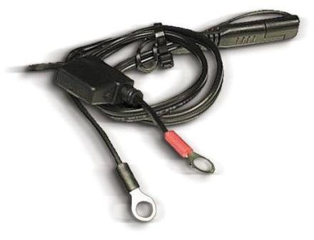

I just installed a Battery Tender pigtail with fuse.
This will allow me to charge the battery during the winter wihtout taking it off the bike. I have never done this (charge the battery in place), my preference is to take it off, but it is too much work in my current scooter.
This is the Battery Tender pigtail with fuse that I am talking about, also called Battery Tender Quick Connect Cable
