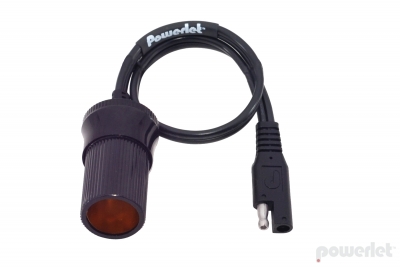

Another option, this from Powerlet, SAE to cigarette socket, should be on the shelf at Dualsport Plus.
