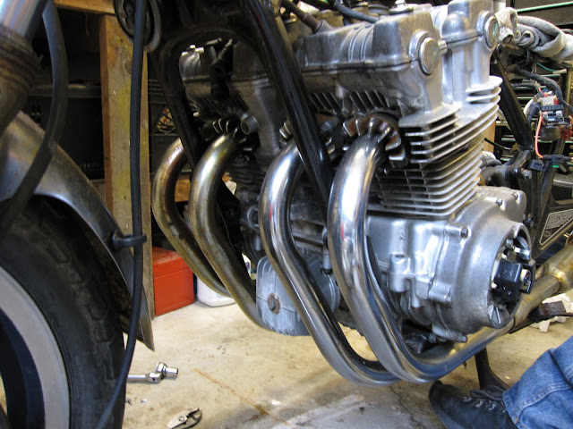

Removed what I believe are called the crash bars...
http://lh4.ggpht.com/_awDuVaHRyjA/TH...stom%20075.jpg
Here they are off the bike...
http://lh3.ggpht.com/_awDuVaHRyjA/TH...stom%20076.jpg
Then removed the exhausts...
http://lh3.ggpht.com/_awDuVaHRyjA/TH...stom%20078.jpg
http://lh6.ggpht.com/_awDuVaHRyjA/TH...stom%20077.jpg

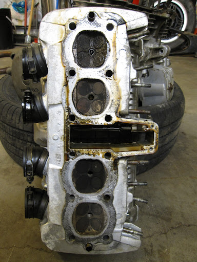

And the kicker of the night, I thought I could just sneak the head head off with the engine still in the frame... I was wrong, had to pull the engine out last minute...
http://lh4.ggpht.com/_awDuVaHRyjA/TH...stom%20088.jpg
Definately needs a cleaning...
http://lh6.ggpht.com/_awDuVaHRyjA/TH...stom%20090.jpg
Finally, mission accomplished...
http://lh4.ggpht.com/_awDuVaHRyjA/TH...stom%20091.jpg

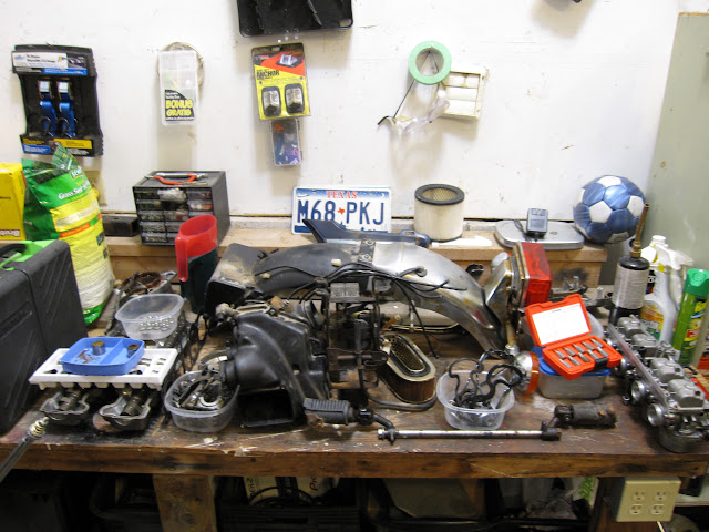

The ever increasing organized mess on my work bench...
http://lh3.ggpht.com/_awDuVaHRyjA/TH...stom%20089.jpg

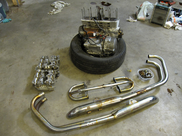

Here's my nights work on the floor...
http://lh3.ggpht.com/_awDuVaHRyjA/TH...stom%20092.jpg

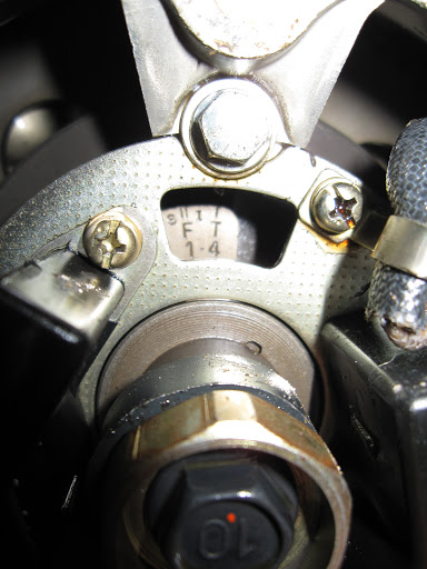

Got the cams back in, set the timing of crankshaft, intake camshaft, and exhaust camshaft... Installed the camshaft holders... Lightly at first... Turned the engine by hand to ensure proper timing... Then again... Then again... Then again... And a few more times... While torquing down the cam holder bolts **** hit the fan for the night... Notice in the pic, two bolts are missing from the cam holders that are installed...
http://lh5.ggpht.com/_awDuVaHRyjA/TH...stom%20097.jpg
Closeup of the missing bolts...
http://lh4.ggpht.com/_awDuVaHRyjA/TH...stom%20098.jpg
http://lh3.ggpht.com/_awDuVaHRyjA/TH...stom%20099.jpg
And here they are... Before the questions, let me say, I followed the torque specs from the Clymers manual... 9 - 12 ft/lbs... I used 12 ft/lbs... Decided after (it was too late) that I should have used 9 ft/lbs... But I'll get the bolts from work tomorrow so no big deal... Damn lucky they didn't snap IN the block, they just make a "crack" sound, so I backed them out and saw the stretch marks... I busted them by hand after that... Lesson learned... Don't use max torque when doing this...
http://lh3.ggpht.com/_awDuVaHRyjA/TH...stom%20100.jpg

Are the cam caps marked or did you mark their location?
Just wondering if the caps got mixed up???

They're all marked alphabetically, also I kept the dowels and bolts in their original positions too... I got some replacement OEM honda bolts from work, they're a few threads shorter but same grade bolts... Should be alright to use them...
