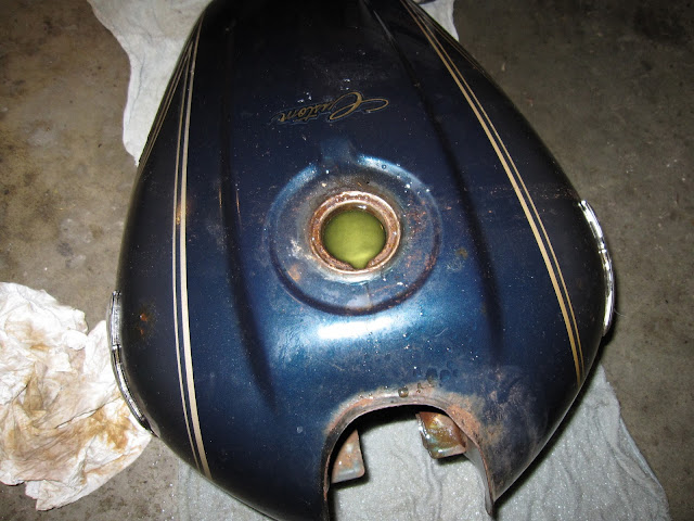

Removed fuel tank and drained out 15 year old nasty fuel...

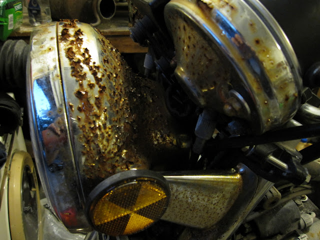

Tested my chrome cleaning skills, any advice on getting the fine pitting out?

This healight housing is a total loss... Possibly the guage housing too...
http://lh6.ggpht.com/_awDuVaHRyjA/TG...stom%20017.jpg
Done draining out the junk...
http://lh5.ggpht.com/_awDuVaHRyjA/TG...stom%20020.jpg
Inside the tank after draining... Gross...
http://lh5.ggpht.com/_awDuVaHRyjA/TG...stom%20019.jpg
After varsol + hot water rinse...
http://lh6.ggpht.com/_awDuVaHRyjA/TG...stom%20021.jpg
Mixture of muriatic acid (2l) and full tank of hot water... (3 hour soak)
http://lh4.ggpht.com/_awDuVaHRyjA/TG...stom%20022.jpg
And once the acid bath was done, rinse with water followed by a rinse with gasoline... It's now filled to the cap with clean gasoline...

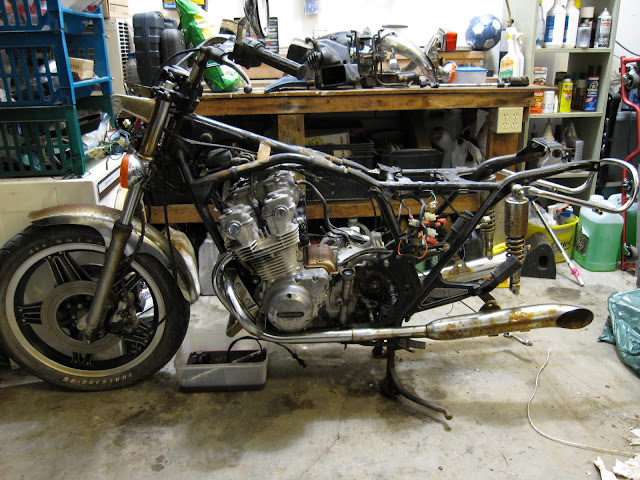

Also removed: rear wheel, swing arm, chain... And ensured that I could hand turn the engine before moving forward with this project... As I was hand turning, my stuck spark plug shot out! Still need to remove the seized threads though... Only the core shot out...
http://lh5.ggpht.com/_awDuVaHRyjA/TG...stom%20023.jpg
http://lh4.ggpht.com/_awDuVaHRyjA/TG...stom%20024.jpg
http://lh6.ggpht.com/_awDuVaHRyjA/TG...stom%20025.jpg

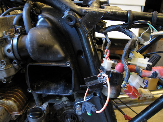

First was to fix this busted fusible link type fuse... No one sells these apparently...
http://lh5.ggpht.com/_awDuVaHRyjA/TG...stom%20028.jpg
So I bought this instead...
http://lh4.ggpht.com/_awDuVaHRyjA/TG...stom%20040.jpg
To make this... I will make it cleaner later... This was just to get started...
http://lh5.ggpht.com/_awDuVaHRyjA/TG...stom%20039.jpg

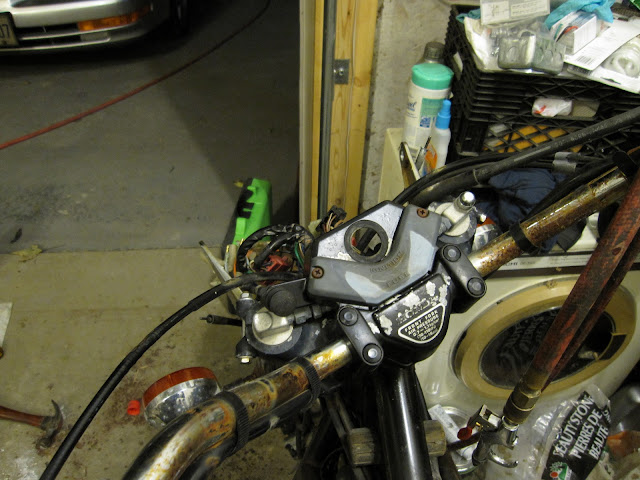

Next, I still can't turn the ignition... That had to come out...
http://lh6.ggpht.com/_awDuVaHRyjA/TG...stom%20033.jpg
http://lh6.ggpht.com/_awDuVaHRyjA/TG...stom%20034.jpg

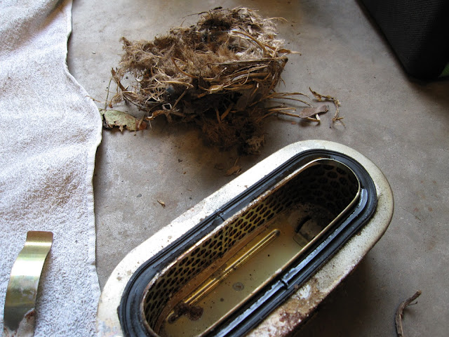

Removed the air filter, found a rodent nest inside the air box... Super...
http://lh6.ggpht.com/_awDuVaHRyjA/TG...stom%20029.jpg
http://lh4.ggpht.com/_awDuVaHRyjA/TG...stom%20030.jpg

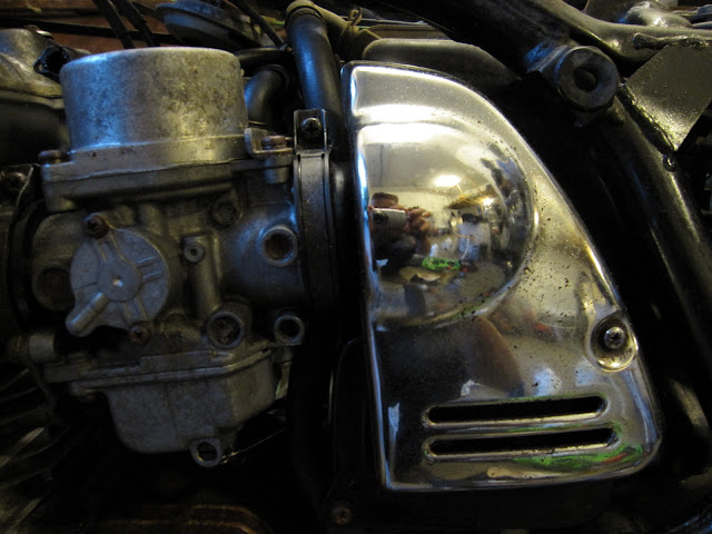

And took off the tops of the carbs and took a peek, here's what I saw...
http://lh4.ggpht.com/_awDuVaHRyjA/TG...stom%20031.jpg
I don't know what's good or bad... This looks ok to me, but I think the mess is in the lower half of the carbs... Right?...
http://lh5.ggpht.com/_awDuVaHRyjA/TG...stom%20032.jpg

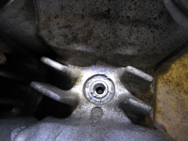

2) Spark plug issues... No 4 plug, the one that snapped... The one where the core shot out when I was hand turning the engine... The one that now has seized threads in said cylinder... I tried to get that out with an extractor bit set from CT... Broke one bit that was too small for the job... And got the larger bit to bite hard but it won't turn...

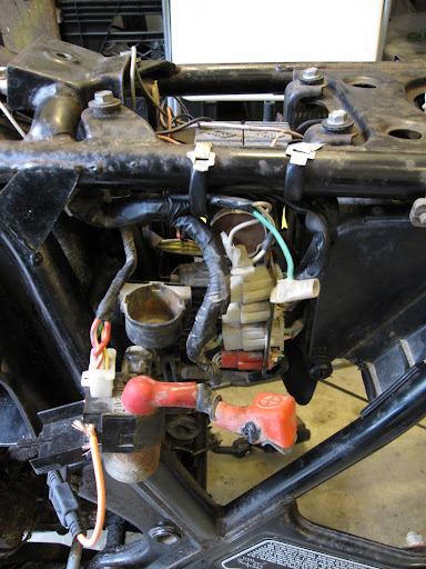

Still trying to ID this component, looks like an alarm to me...
http://lh3.ggpht.com/_awDuVaHRyjA/TG...stom%20044.jpg

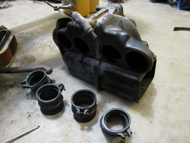

Now the air box had to come out... Took me a while to figure out to take the carbs out after loosening the air box before trying to get the air box out...
http://lh5.ggpht.com/_awDuVaHRyjA/TG...stom%20046.jpg
So, carbs out...
http://lh3.ggpht.com/_awDuVaHRyjA/TG...stom%20049.jpg
Then the air box can be removed...
http://lh4.ggpht.com/_awDuVaHRyjA/TG...stom%20048.jpg
Now it looks like this...
http://lh4.ggpht.com/_awDuVaHRyjA/TG...stom%20050.jpg
http://lh5.ggpht.com/_awDuVaHRyjA/TG...stom%20051.jpg
Keeping in mind I don't know carbs very well, I opened up the bowels and took a look...
http://lh4.ggpht.com/_awDuVaHRyjA/TG...stom%20052.jpg

Still need to figure out the spark plug thread romoval for #4 Cyl...
http://lh4.ggpht.com/_awDuVaHRyjA/TG...stom%20061.jpg

And I wasn't going to do pics today... But why not...
Here's a pic the the bike's condition when I finished my last session on it... I would have put it with my last post but it didn't fit...
http://lh4.ggpht.com/_awDuVaHRyjA/TG...stom%20062.jpg

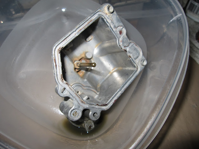

Today is a clean carbs day... Keep in mind I've never done this before, I'm working with the internet and mechanical aptitude...
So... I took the bowls off again, removed the pin that holds the float in place, then the jets... Also removed the gaskets... Then used the bowls as, well, as bowls to hold carb cleaner to allow the removed parts to soak... (not soaking the gasket or floats mind you...)
Notice #2 is in a tilted tupperware container... I broke a bolt (damn) so it's soaking in penetrating oil overnight... Extraction tomorrow hopefully...
http://lh3.ggpht.com/_awDuVaHRyjA/TG...stom%20063.jpg
A little closer...
http://lh4.ggpht.com/_awDuVaHRyjA/TG...stom%20067.jpg
And close up of said #2 bowl with the broken bolt in the penetrating fluid...
http://lh4.ggpht.com/_awDuVaHRyjA/TG...stom%20069.jpg

Oh! And good news... I think I know why no fuel was getting into the carbs... The main fuel line from the tank goes into a vacuum activated diaphragm type device... Vacuum pulls down on a rubber diaphragm and allows fuel to flow...
(please correct me if I'm wrong someone, I'm just saying my thoughts)
So I took that bastard apart today and the diaphragm was sticking even with vacuum... So I cleaned it up and did a butchered bench test and seems ok now...
Next will be carb rebuilding, then head removal I think for the damn spark plug issue... Then after that, rebuild and start?

So I'm trying to learn the names of these carb parts here... So far I think what I have in this pic are: Front and centre are both jets, one main and one slow jet... Right of that is the float arm pin, and behind... Main nozzle? Anyone, anyone?
Main, Pilot and needle jet holder.
